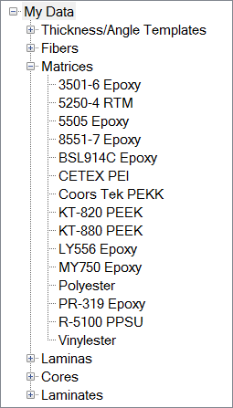

The file tree can be used to quickly view the list of materials available in the material database. Simulation Composite Design comes with a large number of Fiber, Matrix, Lamina, and Core material types already defined in the material database. Click the (+) button located to the left of the material type of interest in the material tree to view the list of individual materials available under each type of material. To hide the list of individual materials available under a particular type of material, simply select the minus (-) button located to the left of the material type in the material tree. The image above shows the file tree after opening the Matrices branch.

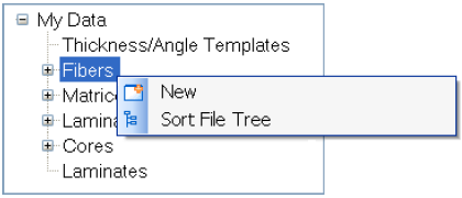

  1. New - Create a new thickness/angle template, material, or laminate data file that will be added to the material database. When using this option, you must explicitly specify all parameters needed to define the new thickness/angle template, material, or laminate. This option can be accessed by right-clicking on a particular branch within the file tree and selecting New. The image below shows the New option being accessed to create a new Fiber material data file.

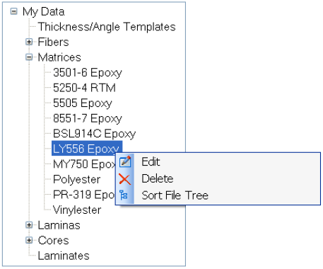

  3. Edit - Edit any of the material data files or thickness/angle templates that appear in the material data file tree. Right-click a particular material data file or thickness/angle template that appears in the material data file tree and select Edit to access this option. The image below shows the options available after right-clicking the Epoxy material data file that appears on the Matrices branch.
  4. Delete - Delete material files from the material database. Right-click a particular material data file or thickness/angle template that appears in the material data file tree and select Delete to access this option (see image below).

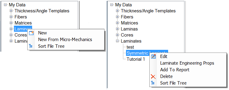

  5. New From Micro-Mechanics - Create a new Lamina material by using micro-mechanics to define the lamina properties resulting from a combination of fiber and matrix materials stored in the material database. This option is accessed by right-clicking on the Laminas branch and selecting the option New From Micro-Mechanics (see below).
  6. Laminate Engineering Props - Calculate and display the 2D and 3D material properties of a Laminate. Right-click a laminate that appears in the Laminates branch and select Laminate Engineering Props to use this option (see below).
