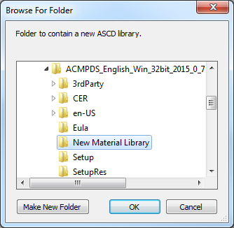

- New Material Library
- Create a new material library. New material libraries cannot be saved in the same folders containing the original "acmpds.data" material file. The material library is installed in two locations: to the "Data" folder in the installation directory and to %APPDATA%\Autodesk\Simulation Composite Design 2015\Data. A new folder can be created in the Simulation Composite Design directory to store a new material library as shown below.

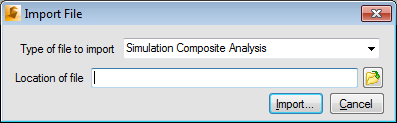

- Import File
- Open the Import File window (see below) where you can import an individual material file into the material database. Simulation Composite Design recognizes six different types of material data files: fiber files (*.fib), matrix files (*.mat), lamina files (*.lma), laminate files (*.lmt), thickness/angle templates (*.lay), and core files (*.cor).

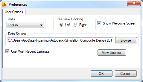

- Preferences
- Open the Preferences dialog box (see below) where you can specify preferences and set licensing options. Each feature accessible within the Preferences dialog box is described below.
- Units - Select English or SI units for all data displayed and for all calculations performed by Simulation Composite Design.
- SI (Pa) units (N/m/K) - strength and stiffness must be entered in Pascals (Pa), density in grams per cubic meter (g/m3), temperature in degrees Celsius (°C), and geometry in meters (m).
- SI (MPa) units (N/mm/K) - strength and stiffness must be entered in mega-pascals (MPa), density in grams per cubic millimeter (g/mm3), temperature in degrees Celsius (°C), and geometry in millimeters (mm).
- English units (lb/in/F) - strength and stiffness are expressed in pounds per square inch (lb/in2), density is expressed in pounds per cubic inch (lb/in3), temperature is expressed in degrees Fahrenheit (°F), and distance is expressed in inches (in).
- Tree View Docking - Select the location where the Material Data File Tree will appear within the GUI - left or right.
- Show Welcome Screen - When checked, the welcome screen is displayed at each startup.
- Use Most Recent Laminate - When checked, the most recent laminate used in a session is automatically applied in each laminate analysis module opened. When unchecked, you are required to select a laminate for each analysis initiated using the Open button.
- Data Source - Select a particular acmpds.data file that will be used to build the material database.

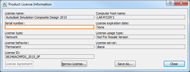

Clicking the View License button in the Preferences window results in the display seen below.
There are several different fields within the Product License Information window, as seen above. Please see Appendix A for more licensing information.
