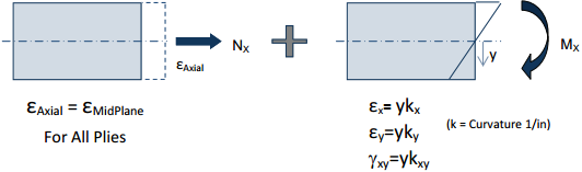

Can laminate loads simply be added together? Sure! For example, consider two loads on a laminate: one axial and one bending. In this case, all we need to do is add the axial strains to the bending strains.
The basic equations are given in the following matrix relation:

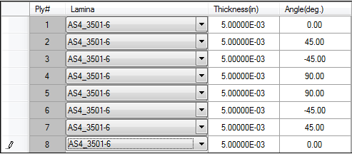

  3. Add the eight plies to the laminate as shown below.

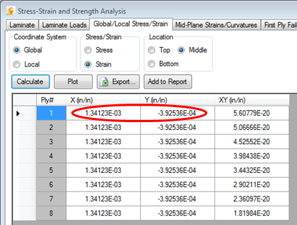

  4. Navigate to the Laminate Loads tab and enter an Axial Load of 10,000 psi.
  5. Navigate to the Global/Local Stress/Strain tab and calculate the strain in the middle of the plies using the global coordinate system.

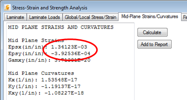

  6. Navigate to the Mid-Plane Strains/Curvatures tab and click Calculate.
    Note: the same result is obtained using either tool.

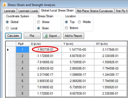

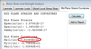

Next, we will add the strain due to the moment by replacing the axial load with the moment.
  1. Navigate to the Laminate Loads tab, remove the axial load and add a Transverse Moment of -1000 lb-in/in.
  2. Navigate to the Mid-Plane Strains/Curvatures tab and click Calculate.
  3. Record the mid-plane curvature Kx
  4. Navigate to the Global/Local Stress/Strain tab and calculate the strain on the top of the plies using the global coordinate system.
Quick hand calculation check:
In this case, our laminate is 0.04 inches thick, thus z=-0.02 inches at the top of the laminate. With that:
εx = vkx or εx= (-0.02 in)(7.81865/in) = -0.156 in/in as shown in Ply #1 above
Now, if we add the axial and bending strain, we get:
εTotal= 1.341E-3 + (-1.56E-1) = -0.155 in/in

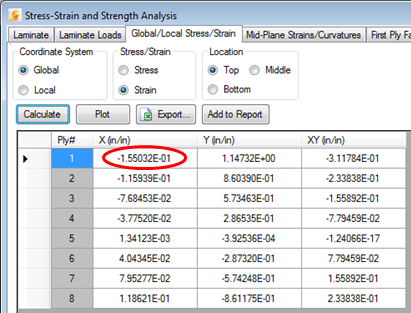

Of course, Simulation Composite Design allows you to apply both loads at once using the Laminate Loads input tab in each of the featured Laminate Analysis functions. In fact, you can apply eight different load factors at once.
Entering our axial and moment loads together, we get -1.55E-2 in/in, which is the same result obtained above by computing them separately and adding them together.
