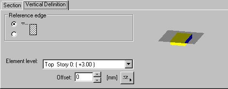

Stairs - vertical definition
On the Vertical Definition tab of the Stairs - definition dialog, you can specify the location of stairs with respect to an active story.
The Element level list includes all the defined levels of an active story of a building. The location of stairs in a building is defined by selecting a plane (for example, Top - Story 2, Bottom - Story 2).
In addition, you can define the reference edge of stairs with respect to the upper or lower level of a story:
Reference edge
Location of stairs with respect to the story level
1.
2.
When defining the vertical location of stairs, you can define an offset from the lower or upper level of a story. If the offset equals 0, the definition line coincides with the upper or lower plane of a story. Click to select a horizontal element edge that determines an offset value.
