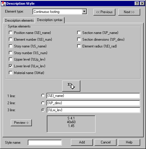

On the Description syntax tab of the Description Style dialog, you can define a syntax of an element description.
Define the syntax:
Under Preview, the element description displays, as you defined it. This description is based on numerical values saved as fixed. The description updates when you change preferences (change of unit, precision), but units are not displayed in the preview.
If it is necessary to define more than 3 description lines, you can break text in the last line by using the symbol \P. This is a standard symbol used in AutoCAD (see also AutoCAD program mechanisms).
Variables included in the element description:
