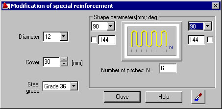

The following dialog displays:
The following parameters of a reinforcing bar (special reinforcement) can be modified:
- A bar diameter (the edit field shows the current reinforcing bar diameter)
- A reinforcing bar cover (the edit field shows the current reinforcing bar cover)
- Reinforcement grade (the current steel grade is selected on the selection list)
- Shape parameters depending on a selected type of the special reinforcement.
