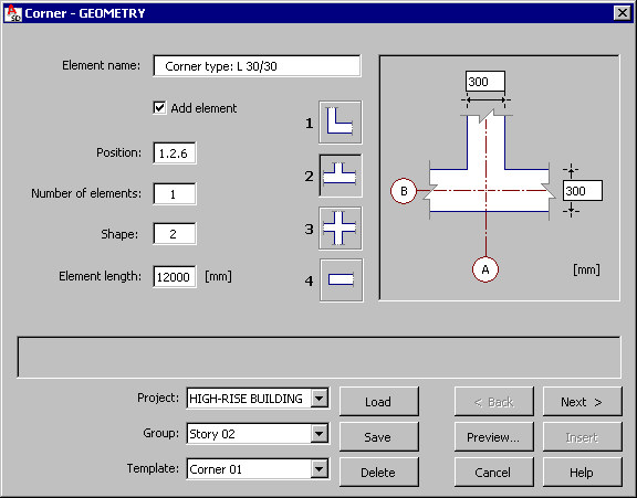

This option is used to define the geometry and reinforcement of an RC slab corner. There are three ways to access this option:
The following dialog displays:
The following information displays in the top part of the dialog:
Select the Add element option to group the reinforcing bars (or reinforcing wire fabrics) of the corner reinforcement into an element while generating the formwork / reinforcement. The name specified in the Element name field is added on the Model tab of the Object Inspector dialog. The element (the group of reinforcing bars) displays in the Element manager dialog.
Once corner geometry is specified, dimension values of the corner are defined; the number of dimensions depends on a corner shape type. A schematic drawing of a corner adapts itself to the selected corner shape. In a schematic drawing of a corner another parameter may be specified:
After completing definition of corner dimensions and clicking Next, the Corner - reinforcement dialog displays . The contents of the dialog depends on a corner type selected.
