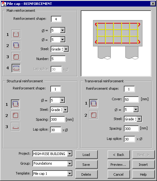

After defining the pile cap dimensions, click Next. The following dialog displays:
The upper part of the dialog includes parameters of main reinforcement in a pile cap. There are four types (shapes) of main reinforcement:
The following parameters should be specified for main reinforcement:
A length of a reinforcement lap splice should be determined for the second reinforcement type, and for the last reinforcement type - a number of reinforcing bars.
The length of a reinforcement lap splice may be defined in two ways:
In the middle part of the dialog, parameters of structural reinforcement of a pile cap are provided (the options are available for a pile cap for two piles and after selecting fourth reinforcement type). Three types (shapes) of reinforcement are available:
The following parameters of structural reinforcement should be defined:
In addition, for the first reinforcement type a length of a reinforcement lap splice should be specified. The length of a reinforcement lap splice is defined in two ways:
The bottom part of the dialog includes parameters of transversal reinforcement of a pile cap. Two reinforcement types (shapes) are available:
The following parameters should be defined for transversal reinforcement:
For the first reinforcement type, the length of reinforcement lap splice should be defined.
In the upper part of the dialog, a type of the main reinforcement of a pile cap should be selected:
- circumferential reinforcement
- orthogonal reinforcement
For the main reinforcement two types (shapes) of reinforcement are available:
The following parameters should be specified for the main reinforcement:
The lower part of the dialog includes parameters of the structural reinforcement of a pile cap. The structural reinforcement will be generated if the Structural reinforcement option is selected (the
symbol appears). If the Structural reinforcement option is cleared, options in this field are not available and the structural reinforcement will not be generated in a pile cap.
Two types (shapes) of the structural reinforcement are available:
The following parameters should be given for the structural reinforcement:
In the case of first reinforcement type a length of a lap splice should be specified additionally. The length of a lap splice are defined in two ways:
The lower right part of the dialog includes parameters of additional reinforcement of a pile cap. Options provided in this part of the dialog are available only for the circumferential reinforcement (after clicking
for three piles or
for four piles).
Additional reinforcement of a pile cap will be generated if the Additional reinforcement option is selected, the
symbol appears. If the Additional reinforcement option is cleared, options in this field are not available and this reinforcement type will not be generated in a pile cap.
Two types (shapes) of additional reinforcement are available:
The following parameters should be specified for this reinforcement type:
