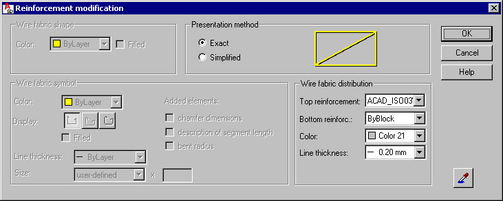

After selecting the Modify: Graphical parameters of reinforcement option, and selecting wire fabric reinforcement, the following option displays:
The Wire fabric distribution field allows you to:
- Modify the style of lines applied to draw top / bottom reinforcement
- Modify color and line thickness for elements of reinforcement distribution.
Note: The remaining options are not available in the current version.
