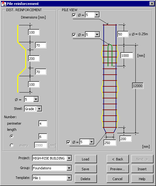

After defining the pile transversal dimensions and reinforcement in the pile cross-section, click Next. The following dialog displays:
The left part of the dialog includes parameters of the 'goalposts' reinforcement (distance reinforcement) provided over the length of an RC pile. The following parameters should be defined for the 'goalposts' reinforcement (distance reinforcement):
- by defining a number of segments within which the 'goalposts' reinforcement is to be distributed
- be defining a spacing between the segments within which the 'goalposts' reinforcement is to be distributed.
The right part of the dialog holds reinforcement parameters presented in the pile longitudinal section (pile view). The PILE VIEW field enables additional parameters of pile reinforcement:
