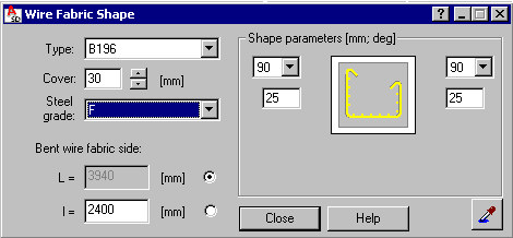

After selecting the option and a wire fabric in the cross section, the following dialog displays:
The following parameters of a wire fabric in the cross section can be modified:
- Wire fabric type (the current wire fabric type displays in the edit field)
- Wire fabric cover (the current wire fabric cover displays in the edit field)
- Reinforcing steel grade (the current steel grade is selected from the selection list)
- Bent wire fabric side (a shorter or longer wire fabric side should be selected)
- In the Shape parameters field - parameters of the hook ending of a wire fabric, i.e. a hook angle and length.
