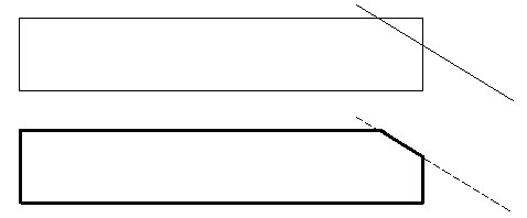

To make a section through a steel section:
Cut the profile by specifying positions of two points that define a line. Additionally, a direction is indicated (a point on one side of the cutting line): it determines the object part that will be cut.
