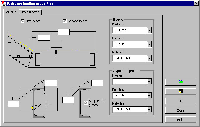

After you select a landing on the Staircase landings and flights of stairs tab of the Staircase dialog and then click Properties, the Staircase landing properties dialog displays.
The dialog has 2 tabs: General and Grates/Plates.
Use the General tab to define landing geometry:
Use the Grates/Plates tab to define dimensions (grates/plates, distances from the edge, and so on).

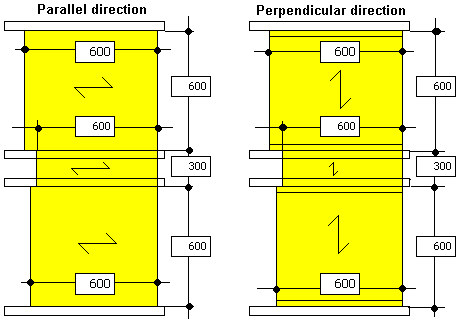

You can also define the main direction of a grate (these options are not accessible for plates); positioning of a grate is illustrated schematically in the drawing below.
Profiles available on the selection list are those defined in the Profile List dialog. To add a profile to the list, click
. The Profile list dialog displays, where you can select a profile.
Profile families available on the selection list are those defined in the Family Manager dialog. To add a family to the list, click
. The Family manager dialog displays, in which you can select a family.
