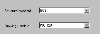

After you click Standards from the left pane of the Project preferences dialog, the parameter options are as shown.
Use these options to select standards used in Autodesk AutoCAD Structural Detailing: a standard of the steel structure design and a drawing standard (drawings of steel structure elements). A selected drawing standard imposes designations (such as hatching symbols) that are valid in the country from which the standard originates.
Available standards:
