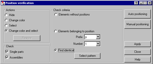

Use this option to control designations of positions ascribed to elements in the process of manual or automatic positioning.
Positioning is verified through searching for positions that either fulfill or do not fulfill selected conditions of positioning.
To begin verifying positioning for the entire structure model, open the Positions verification dialog from:
Verification of positions is performed for the entire structure model.
Under Actions, select an operation to perform on elements found during position verification (Hide, Change color, Select, or Change color and select). The effect of an action is remembered until you click Restore or until the dialog is closed and regeneration is carried out.
Under Check, you can choose elements (single parts or assemblies) to be taken into account during structure verification.
Under Check criteria, indicate the elements to be searched in the process of verification:
Click Apply in order to run the verification (the options in the Check criteria field). After verification is carried out on all objects that satisfy the selected criterion, the operation specified under Actions will be performed. In addition, the command line provides information about the number of elements found that fulfill the defined criterion:
Position verification
Identical elements: 10 found.
If you have specified Select for Actions, you can use the buttons at the top right of the dialog to run positioning of elements found and selected during verification:
