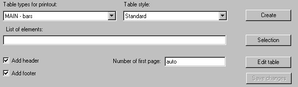

After you select Table composition from the selection tree in the left part of the Table printout manager dialog, the options shown below display on the right.
For steel structure elements, choose a table type:
For RC structure elements, choose a table type:
For each table type, you can choose a table style defined previously for the selected table type.
Click Create to generate a table of a given type based on the current element list (if the list is empty, a printout of a whole structure is made) in the format of the active table style (see: Styles applied in tables).
The List of elements field displays numbers of the elements included in a table. Clicking Selection closes the dialogs and lets you graphically select elements to be included in the table.
Clicking Edit table lets you graphically indicate the table to be edited. Changes made in a table may be saved after you click Save changes.
