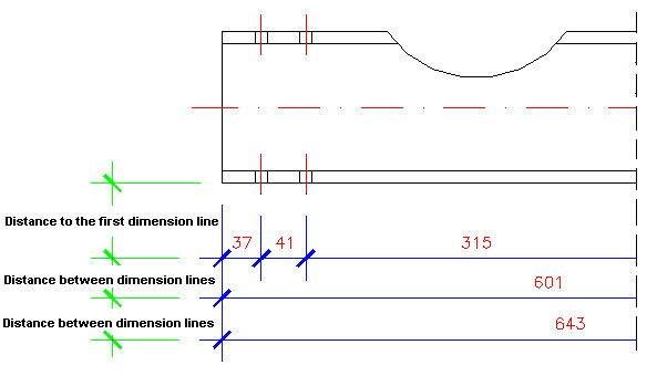

- Distance to the first dimension line - specify the distance between the edge of a dimensioned part and the first dimension line generated automatically
- Distance between dimension lines - specify the distance between successive dimension lines (see drawing below)

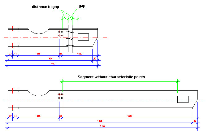

- Parts shortening - if this is selected, long elements (element segments that do not include any characteristic points) will be shortened in a final drawing. The element shortening is displayed as a gap in a shortened element.
Element shortening will be performed if the element segment (not including any characteristic points) is longer than a value of the user-defined minimal distance without details. The drawing below illustrates the same element, shortened (top part of the drawing) and not shortened (bottom part of the drawing).
 You can define a type of break line to use during element shortening; the list contains all available line types in AutoCAD®, saved in a DWG format file. Thickness and color of the break line are identical to those of an element contour.
 Additional parameters of shortening can be specified (see drawing below): gap value, and value of the distance to gap (distance between a characteristic point and a gap).
