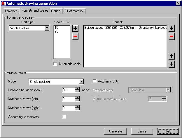

On the Formats and scales tab of the Automatic drawing generation dialog, you can define scales, formats, and views for an option (object) selected in the Part type field.
For Scales, you can define scale values between 0.1 and 500. To add a scale value, click the + button. Click the – button to delete the currently selected scale value from the list. If you select Automatic scale, the Scales field is no longer available, and the scale is calculated by the software in such a way that it lays out the drawings on the printout optimally.
For Formats, you can specify any number of template files. To add a template to the list, click the + button (an additional dialog opens, where you select a *.dwt format file). To delete the currently selected template from the list, click the – button. After you choose a template on the list, you can click the
buttons to move the template up or down in the list. When you generate views of parts, templates are viewed from top to bottom of the list.
Under Arrange views, specify view parameters:
After selecting the According to template option, the previous options become unavailable. Views are generated based on the template settings.
If the Automatic cuts option is selected, cuts are created in views based on the user-specified parameters (standard view and maximum number of cuts).
