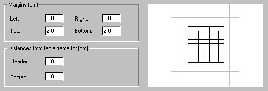

After you select Distances from the selection tree in the left part of the Table printout manager dialog, the options shown below display on the right.
Under Margins, specify left, right, top, and bottom page margins.
Under Distances, define distances between the table frame and the header or footer.
The size of a header and footer is calculated automatically in the software; the parameters mentioned depend on a size of the applied font, size of a drawing with the company logo, and number of lines required in a header or footer.
