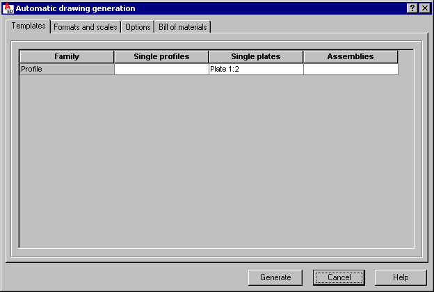

On the Templates tab of the Automatic drawing generation dialog, you can define the type of a part and the family to which it belongs.
Assign a single part template or an assembly template to each family:
Autodesk AutoCAD Structural Detailing templates define a set of parameters for each view and for a set of views and scales.
For automatic generation of drawings, a scale for views is defined in the dialog rather than taken from a template.
