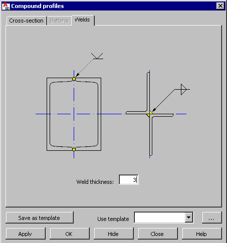

After you have defined the geometry of a compound profile use the Welds tab to define thickness of welds (a fillet weld or a butt weld depending on the type of profiles in the compound profile) along the profile length.
At the bottom of the dialog is the Use template selection field, which contains user-defined templates (schemes) of compound profiles. After you define compound profile geometry, you can save the settings by typing a name in the Use template field and clicking Save as template. In the future, after you begin to define a compound profile, you can select the name of a saved template so that all its parameters will be applied to the new compound profile.
Use the buttons at the bottom of the dialog:
