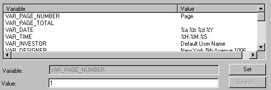

After you select Parameters from the selection tree in the left part of the Table printout manager dialog, the options shown below display on the right.
The dialog contains all the variables defined in the system and their names.
Variables used for formatting the header and footer of the printout:
VAR_PAGE_NUMBER - lets you assign a current printout page. If VAR_PAGE_TOTAL is used, text assigned to the variable will precede the total number of pages (for example, Page 1, Page 2, and so on)
VAR_PAGE_TOTAL - value of this variable indicates the total number of printout pages. Text assigned to it may be preceded by a current page number, if the VAR_PAGE_NUMBER variable is used.
