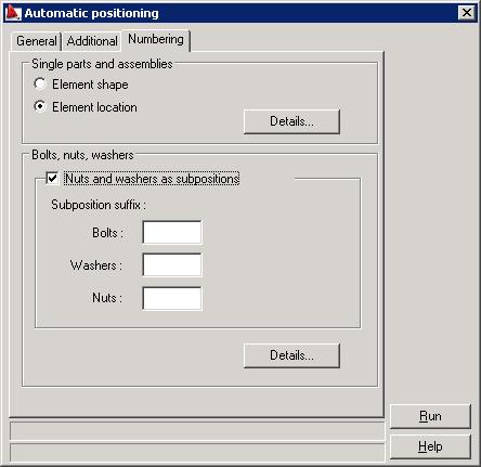

Use the Numbering tab on the Automatic positioning dialog to specify sorting criteria for position numbering.
Single parts and assemblies can be sorted by:

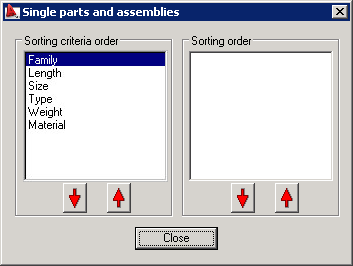

That which of these options is selected determines options available in additional dialog boxes that open after you click Details. If you select Element shape and click Details, the following dialog displays.
In this mode, the numbering order is determined based on selected properties of the element shape.
Specify additional sorting parameters:
buttons to move the selected parameter up or down the list, thus defining the required sorting order.

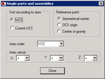

buttons to move the selected property up or down the list, thus defining the required sorting order. If you select Element location and click Details, the following dialog displays.
In this mode, successive numbers are ascribed based on the position of the element reference point in the coordinate system.

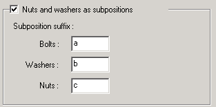

Below on the Numbering tab is the Nuts and washers as subpositions option. It determines the method that positions are assigned to connectors.
After the positioning is completed, you will obtain the following subpositions: bolt 200a, washer 200b and nut 200c.

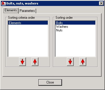

Clicking Details at the bottom of the Numbering tab opens the Bolts, nuts, washers dialog that has 2 tabs:
Use these two tabs to configure the order of assigning positions to elements.
