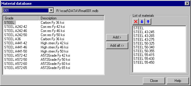

The Material database dialog displays after you click Database on the Materials tab of the Project preferences dialog.
In the dialog, you can add materials from databases accessible in the program to the list of available materials. To add a material to the list:
Clicking Add all >> adds all the materials included in the left pane.
Clicking
deletes a selected material from the list of available materials.
