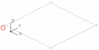

Defining the workplane at current UCS, in the XOY plane
The position of the workplane depends on the position and orientation of the UCS, in the XOY plane.
Select a point where the workplane will be positioned and enter a name for the workplane.
The workplane is positioned in the XOY plane and the name is displayed next to the lines that define it and in the Project Explorer.

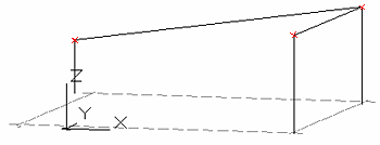

Define the workplane by three points
The plane is defined by any three selected points. The new workplane is not dependent on the position and orientation of the UCS.
Tip: You can create help-lines in order to precisely define the work plane.

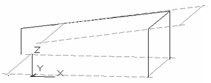

For example, define three points as in the following picture and name the workplane.
The new workplane is created.
