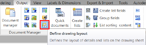

  1. Start the Define Drawing Layout command.

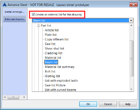

  2. On the "External drawing list" tab, select the "Create an external list for this drawing" option.
  3. Select a BOM from the list below.
  4. Click OK to apply the settings and close the dialog box.

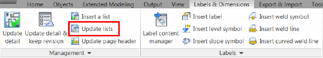

  5. Update the lists using the "Update lists" function.
The external BOM file (in .rdf format) is saved in the same folder with the drawing, having the same name as the .dwg file. The "Update lists" command will work on both the “external BOM” and “BOM on drawing” lists that are on the drawing.
