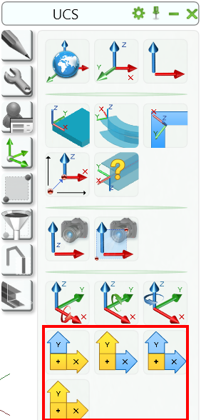

The "X Filter", "Y Filter", "Z Filter" and "XY Filter" commands are available on the UCS tool palette.
These commands are used for displacing a snap point of an object on one of the 3 UCS directions (X, Y, Z), or in the XY plane.
To use these commands:
  1. Select the desired snap point.
  2. Activate one of the 4 filters.
Note: Once a filter has been activated, it is not possible to change it.

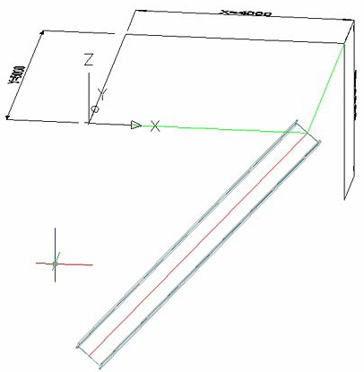

Example: Moving the upper snap point of a beam in one direction
  • Select upper snap point of a beam created on the Z-axis.
  • Activate the X Filter: .
  • Select a point in the workspace with the coordinates 4000, 5000, -3000 relative to the top of the beam. In this case, the top of the beam is moved 4000 units in the X direction.

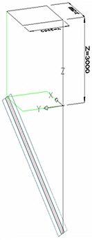

Example: Moving the upper snap point of a beam in the XY plane
  • Activate the "XY Filter".
  • Select a point in the workspace with the coordinates 2000, 2000, 3000 relative to the top of the beam. In this case, the top of the beam is moved 2000 units in the X direction and 2000 units in the Y direction, following the projection of the selected point in the XY plane.
