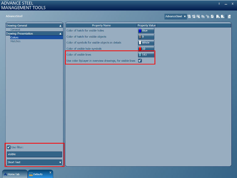

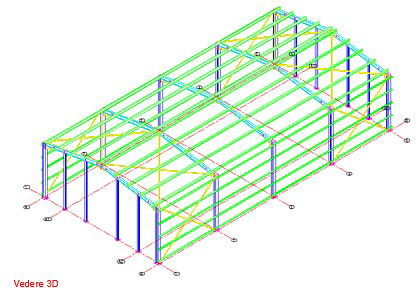

If the "Use color ByLayer in overview drawings, for visible lines" option is enabled, then the color of visible lines display in general drawings is the same as the color used from the layer corresponding with the model.
Tip: Use the Filter options (drawings) to optimize the search.

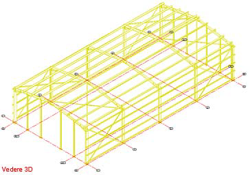

If the "Use color ByLayer in overview drawings, for visible lines" option is disabled, then the color of visible lines of the elements in general (overview) drawings will be set according to the "Color of visible lines" default.
