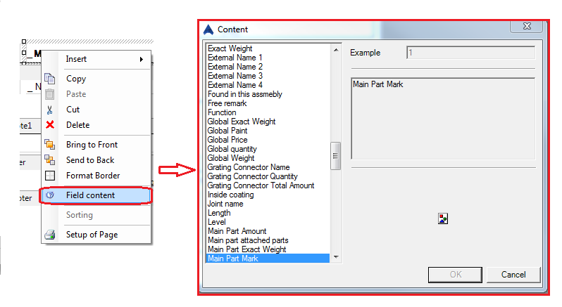

In the BOM editor while modifying the tokens in a template, we can either modify the token in an existing text box or add a new one.
To add a new token:
The same Field content option can be accessed to modify an existing text box and change the token used.

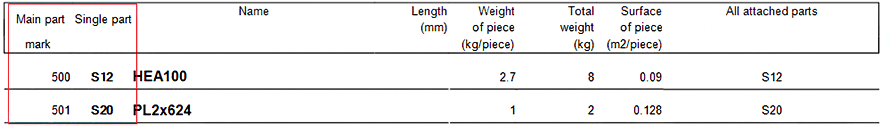

  1. Tokens for part mark
Main part mark - always displays the assembly mark of an object (including objects which are only attached elements) in the Structured list type of BOM templates.
Single Part Mark - displays the single part mark in any condition. This token is available in all template types.
Part Mark - token used to display the part mark of an element based on its state. If the object is a main part in its assembly, this token will display the main part mark. If the object is an attached object this token will display its single part mark.
Preliminary part mark - displays the preliminary part mark of an object.

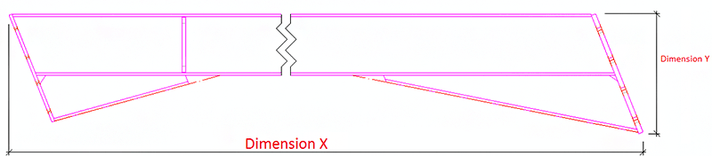

The token names used to display various length values are present in the dimension line on the following pictures:
Dimension X, Y and Z are tokens used to display the gauge dimensions of an assembly. The directions in which these dimension are taken are according to the main part orientation, so X will be along the main part system axis.
For saw cut lists, the BOM editor offers a series of tokens to display the length of various saw parameters and saw angles. Dimension B at flange, Dimension C at web and all the other "Dimension ... at..." tokens return lengths.
