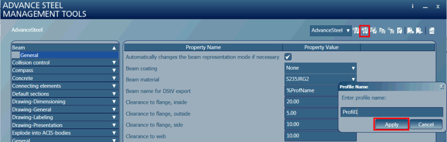

To add a new profile:
  1. Open the Management Tools: Home Settings (Management Tools).
  2. Select the Defaults category.
  3. On the toolbar, click New profile.
  4. In the Profile name dialog box, enter the desired name.
    Note: The entered name cannot contain spaces or special characters such as "\".
  5. Click Apply.
The profile is automatically activated. Any modification of the defaults can be done for it.

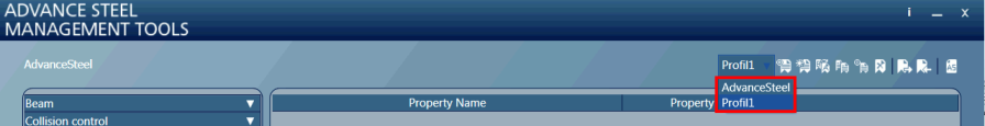

Additional tools for managing profiles
  • To choose another profile or return to the initial one, use the Selected profile drop-down list.
