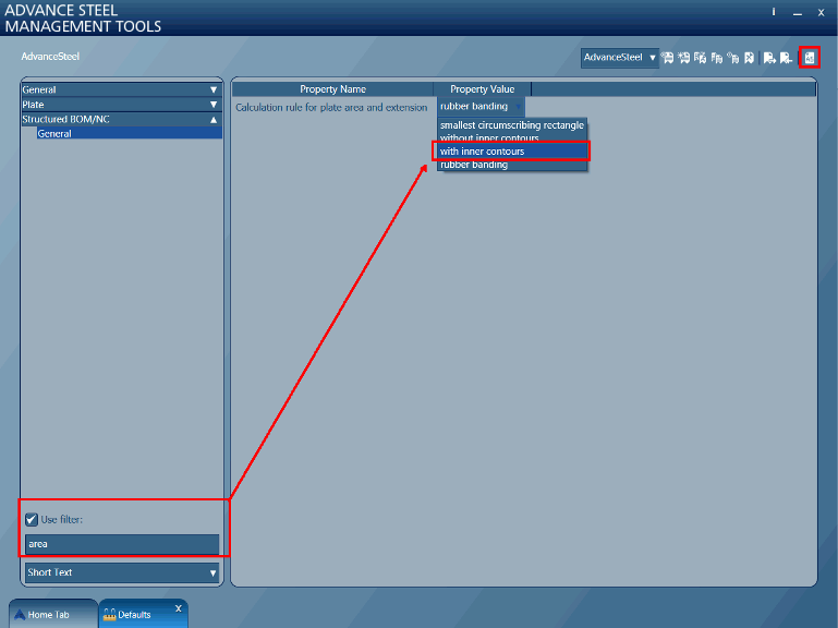

Step 1: Set the correct calculation method
  1. Open the Management Tools: Home Settings (Management Tools)
  2. Select Defaults.
  3. Enable Use filter and enter "area" in the filter field.
  4. From the Structured BOM/NC category select the "Calculation rule for the area" default and change it to with inner contours. With this setting the value will be the exact one, as all the others settings are approximations.
  5. Click Load settings in Advance.
  6. Close Management Tools.

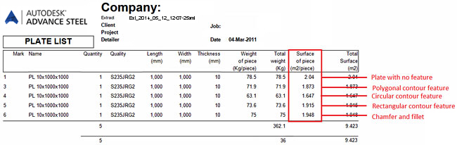

Create a 1sq meter or feet plate. Copy the plate a couple of times and on the copied plates place features (rectangular, circle, polygonal contours, chamfers or fillets).

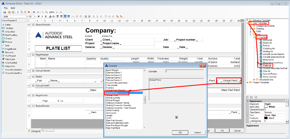

  1. Number the model: Output Part marks (Numbering)
  2. Start creating the list: Output Lists (Create lists)
  3. Create a model extract.
  4. In the BOM Template Editor, from the User Template\Lists\Part Lists category, select the Part list template.
    The "Surface of piece" field content must use the "Global Paint" or "Paint" token.
  5. Click Use and create the BOM list.
The surface column will display the exact total surface of each plate (every side is taken into account, even the 4 sides of the plate that represent the thickness).
