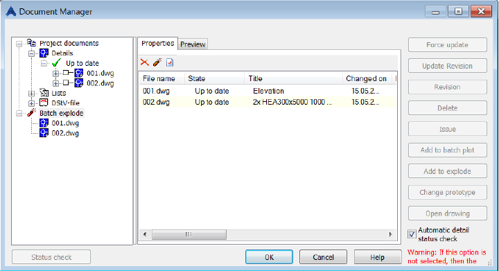

  1. Open Document Manager: on the ribbon, click (Document Manager).
    • Home Documents (Document Manager)
    • Output Document Manager (Document Manager)
  2. Select the detail drawing(s) and click Add to explode.
    The selected detail drawings appear in a new branch named Batch explode.
  3. Click on the Batch explode category.
    You can remove the detail drawings from this branch using Delete ().

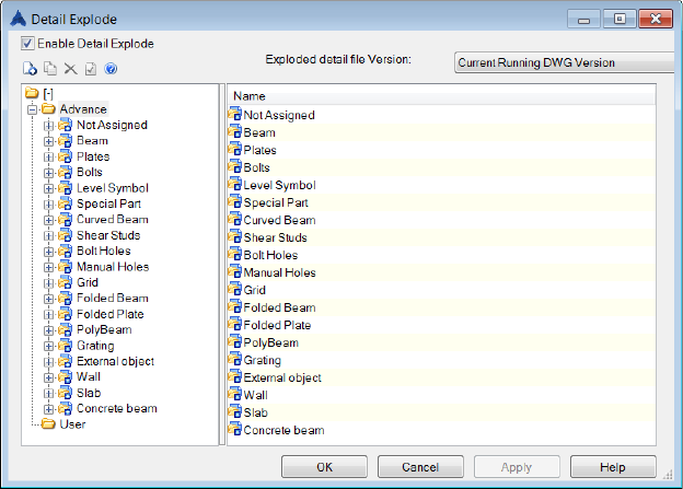

To access the detail explode settings
  1. Click .
    The Detail explode dialog box appears.
  2. Enable details explode by clicking the corresponding option. When you call explode on a detail element the whole detail and all related elements are exploded as it's currently.
    • If "Enable Detail Explode" is disabled, the objects from detail(s) are drawn with the detail color and linetype of the object.
    • If "Enable Detail Explode" is enabled the current selected profile and Advance Steel settings are used.

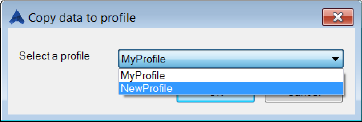

To copy a category
  1. Select the category and click .
  2. Select from the list the destination profile and click OK.
The category is copied to the new profile.
Other categories and / or settings can be copied using drag and drop.

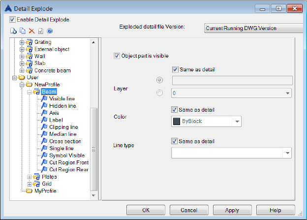

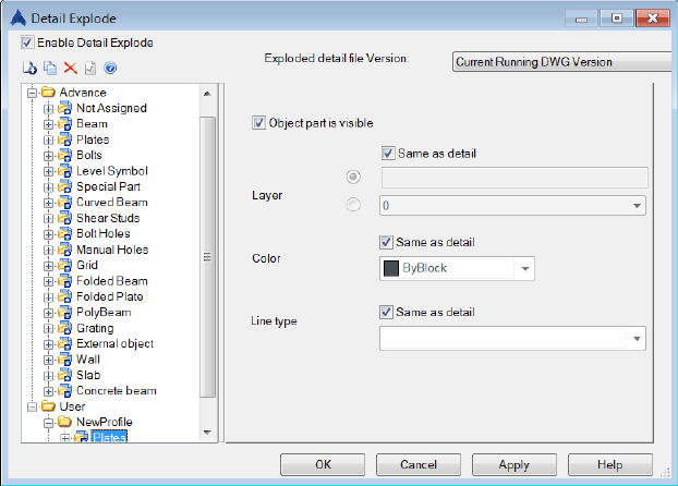

In the right side of the window define the explode settings. Object/Sub-object can be turned ON or OFF, can be placed on a different layer and can be represented with a different color or line type.

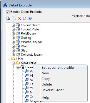

To set one profile as current
Right-click the profile and select Set as current profile from the context menu.
While exploding the detail, for each object / sub-object a corresponding setting will be searched in the "Current Profile". If there is no setting, the explode settings will be used from Advance Steel category.
