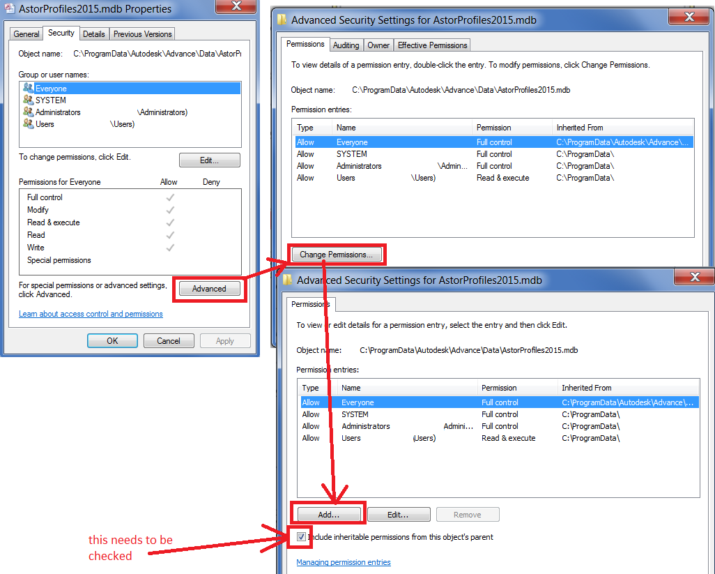

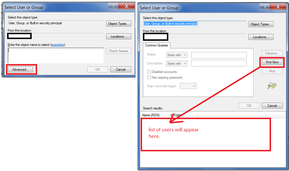

  3. Open the file properties dialog for this database (right click on the file > Properties). Then go to the Security tab to change the security settings for this file (please see the image below).
It's necessary to check the option: "Include inheritable permissions from this object's parent". If this option is turned off then all the added users that should have access to this file will be automatically removed from the allowed access list for this file.

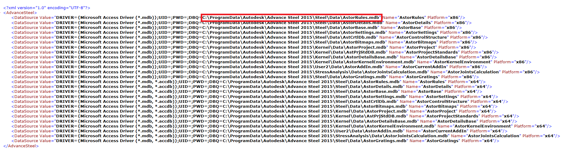

The Configuration location needs to be mapped to each of the Network locations in the configuration file.
Note: You can use find replace in many editors to swap out the mapping path quickly.

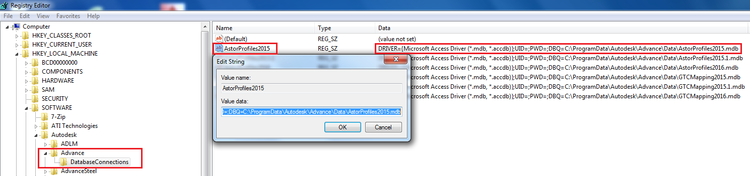

Astorprofiles Database - Change from local PC location.
Note: The same method will apply for the GTCmapping database, used in the Revit transfer process.
Value data entry for Default set to local machine
DRIVER={Microsoft Access Driver (*.mdb, *.accdb)};UID=;PWD=;DBQ=C:\ProgramData\Autodesk\Advance\Data\AstorProfiles2015.mdb
This registry configuration needs to be done independently for each computer, but the DatabaseConfiguration.xml file can be replaced for each computer.
