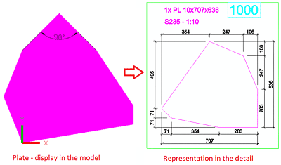

In most cases the plates are orientated on the horizontal direction in the detail, along the longest side. There are a few exceptions in the polygonal plate's case:

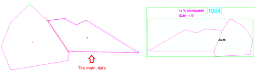

Just as is in the polygonal plate's case, the folded plates are displayed along the longest side. The folded plate is created (in the modeling) by a main plate and the attached plate related with a bending radius. In the detail, the folded plate is orientated by the longest side of the main plate.

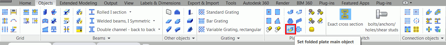

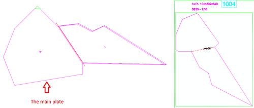

Using the "Set folded plate main object" command, you can change the main plate and the result is different.
