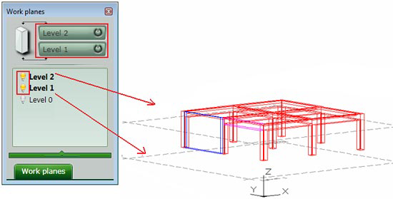

Workplanes can be used for an easier modeling of a structure with levels.
A level is defined by two work planes: one defines the base of the level and the other one defines the upper part of the level.
An element can be attached geometrically to one or two work planes depending on the type of the element and relative to one level.

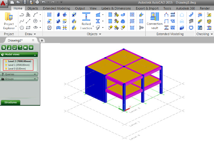

When you create a structure with levels, each created element will be attached to the active level.
The levels are displayed in the Project Explorer.

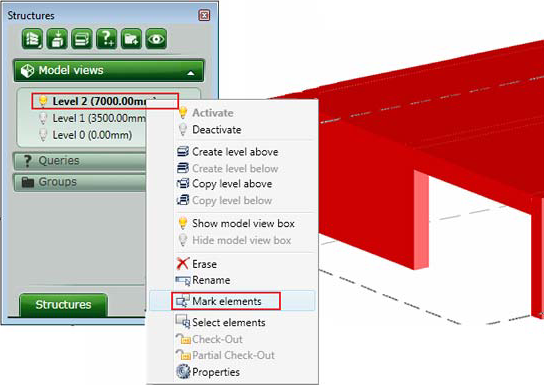

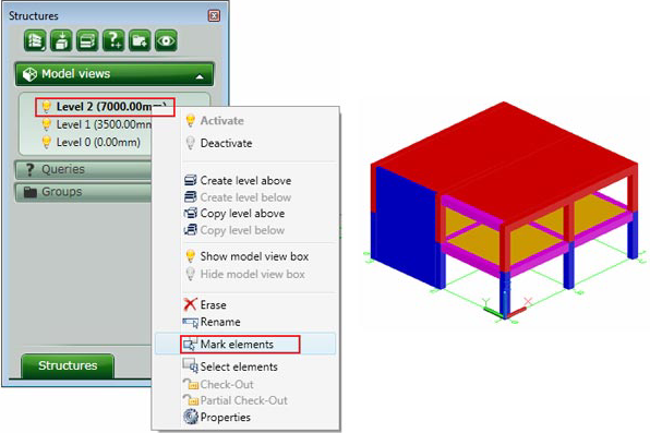

To see the elements that are attached to a level, right click on the level and select Mark elements. The elements that are attached to the level are highlighted.

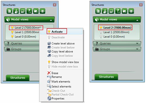

In the Project Explorer, the active level is displayed in bold.
To activate a level, double click on it or right click and select Activate.

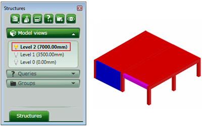

Example: Displaying elements that are not attached to a level
The wall and the beam are not attached to Level 2. To properly attach elements to the desired level, you must follow two steps:

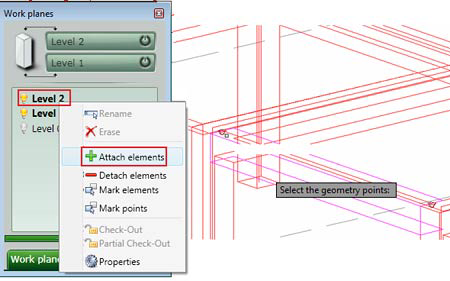

Attach the elements to the work planes of Level 2
Activate Level 2 and then "turn on" the work planes that define the level so you can easily see them.

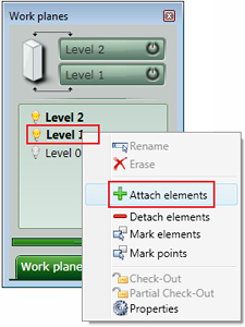

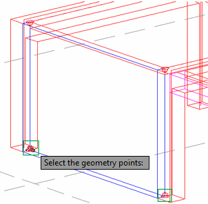

Right click on the base work plane, Level1, and select Attach elements.

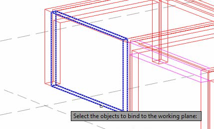

Advance Steel then asks you to select the objects to bind on the work plane. In this example, select the wall, because the wall, as a structural element, is defined also on the height of the level, so the wall must be bound to the lower and upper work planes.
Press Enter to confirm the selection and select the points of the element that will bind it to the work plane.
Select the points on the base of the wall and press Enter.

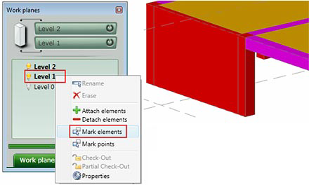

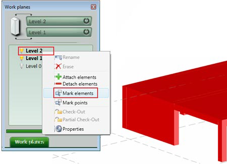

To check if this element is attached to the "Level 1" work plane, right click on the plane and select "Mark elements". Notice that the wall is marked.
The same applies to bind the top part of the wall to the "Level 2" work plane, but this time you will select the upper points of the wall. Attach the beam using the same method, with the difference that it will only be attached to the upper work plane of "Level 2".
Note that both elements are attached to the upper work plane.

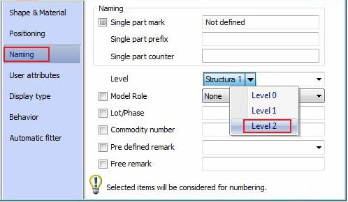

Attach the elements to the corresponding level
This can be done from the properties of each element.
Wall properties
After selecting the level where each element will be attached you can check if the elements belong to the right level.
