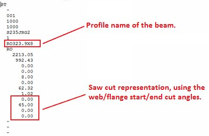

Tube profiles can be represented in NC files in two ways:

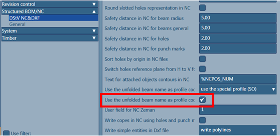

In order to switch between the two behaviors, change the value of the corresponding default in the Management Tools.

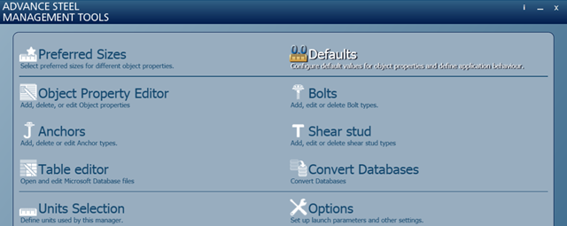

  1. Start the Management Tools: Home Settings (Management Tools).
  2. Select Defaults.
  3. Find the "Use the unfolded beam name as profile code in NC files header" default located in the Structured BOM/NC category.
The tube will be represented in the NC file as a normal beam, as in the following example:

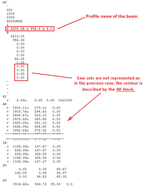

This setting will give the unfolded beam name and describe it as a plate in the NC file. This means the outer contour will no longer be described by the saw cuts, but by an AK block (outer contour block).
