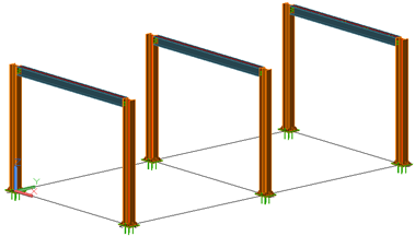

Example: Copy an entire frame
  1. On the Tools tool palette, click (Copy).
  2. Select the entire frame and right click.
  3. Select the base point of displacement.
  4. Select the target point of displacement.
The mono-pitch frame is completely copied with all properties and connections using just two points.
