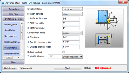

Example: Create a base plate
  1. On the ribbon, click (Connection Vault).
    • Home Extended Modeling (Connection Vault)
    • Extended Modeling Joints (Connection Vault)
  2. From the Plates at beam category, select .
  3. Select the column and right click.
  4. Click OK in the Attention window.
The base plate is created at the end of the column and the properties dialog appears. Modify the baseplate properties to suit specific requirements. Both the column and the plate are welded together.
