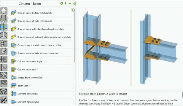

Click Home tab Extended Modeling panel (Connection Vault). Select from the categories of joints in The Connection Vault. Individual element types display appropriate joints.
Group frequently used joints in the Favorites category for quicker access.
