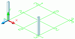

Example: Create straight beams HEA 200 x 2500 mm long
Click a suitable UCS. Refer to the above figure as an example.

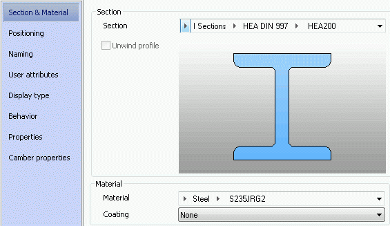

The
Beam
dialog appears. Select the section class (HEA), followed by the section (HEA 200).
