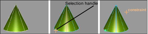

Simple orientation example
  1. Create a cone using Surfaces > Primitives > Cone .
  2. Choose Animation > Tools > Create Constraint and turn on orientation constraint and create selection handle. Click Go.
    A selection handle is created on the new constraint.
  3. Choose Animation > Pick > Selection Handle and click the handle.
  4. Choose Animation > Tools > Move Selection Handle .
  5. Drag the handle away from the cone.
  6. With the handle still picked (the cone will also stay active as it is under the influence of the constraint), choose Transform > Rotate .
  7. Click-drag the selection handle to change its orientation. As the handle rotates, the cone will follow it.

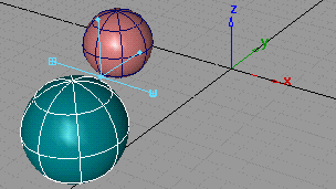

Point example

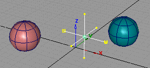

  1. Create two primitive spheres and a jack using Surfaces > Primitives > Sphere and Animation > Tools > Jack .
  2. In the Constrain To Options window (Animation > Tools > Constrain To ), make sure the Point option is clicked ON.
  3. With the jack active, choose Animation > Tools > Constrain To and pick the sphere at the left.
    Notice how the jack moves to the sphere that it is constrained to:
  4. With the jack still active, choose Constrain to and pick the sphere at the right.
    Notice that the jack moves between the two spheres.

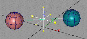

    Note:
    The jack is equidistant from the spheres because the weight of the constraints is equal. If the weight of one constraint was greater, the jack would be closer to the sphere with the greater weighted constraint. To change the weight, use Windows > Information > Information Window .

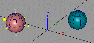

  5. Pick nothing, then pick the sphere at the right.
    The jack changes color to show it is constrained to the selected sphere:
  6. Move the active sphere and then pick and move the sphere to the left.
    The jack moves in relation to the two objects it is constrained to:

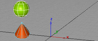

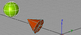

Orientation example
  1. Create a sphere and a cone withSurfaces > Primitives > Sphere and Surfaces > Primitives > Cone .
  2. With the cone picked, choose Animation > Tools > Constrain To and make sure Orientation is ON. Click Go then click the sphere.
  3. With nothing picked, pick the sphere, choose Transform > Rotate and rotate the sphere.
    Notice that the cone rotates along with the sphere.

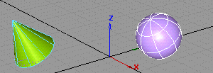

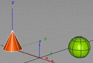

This example illustrates how to make an object always aim toward another object.

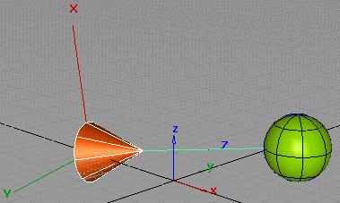

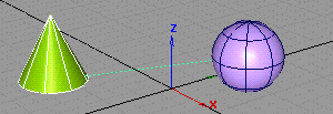

Aim example
  1. Create a primitive sphere and a cone with Surfaces > Primitives > Sphere and Surfaces > Primitives > Cone .
  2. Pick the cone and choose Transform > Local > Set Local Axes to view its local axes.
    Note:
    The point of the cone, the part you want to aim, is pointed up toward Z. To get from the cone to the ball, you have to move along the X axis.
  3. With the cone picked, choose Animation > Tools > Constrain To . An option box appears.
  4. In the option box, make sure that the Aim option is ON.
    Extra controls appear: set the Aim axis to Z and the Up axis to X.
  5. Click Go, then click the sphere. The cone now points toward the sphere.
  6. With nothing picked, pick the sphere, choose Transform > Move and move the sphere.
    Notice that the cone continues to point at the sphere.

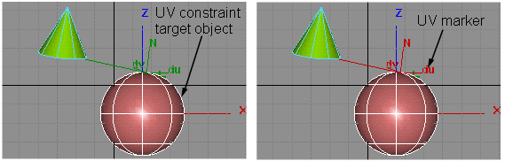

Edit UV constraints
How to pick and modify any UV constraint assigned to a constraint target object.
Edit UV constraints
  1. Choose Animation > Tools > Edit UV Constraint .
  2. Pick the UV constraint target object or constrained object.
    All of the UV constraints related to the picked object will be displayed as markers.
  3. Pick a UV marker or -select an object. The marker is picked when it turns red.
  4. Click the UV marker and move it or enter the UV coordinates in the prompt line.
    Note:
    You can also edit a UV constraint from the Information window by opening the Constraint Info section.

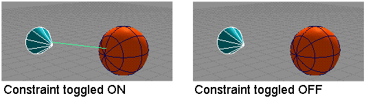

Turn constraints on or off
Use Animation > Edit > Constraints On/Off to enable or disable constraints.
When a constraint is OFF, it behaves as if it does not exist.
This function makes it easier to turn on or turn off a group of constraints. For example, you can toggle states of all existing constraints without picking any of them; set constraints of a group of active objects to be the same state; make changes only on the selected types of constraints (say, only change point constraint); or make changes only to the constraints of your picked hierarchies. You can choose to use the constraints either on the constrained side, or the constraining side of the objects.
To turn constraints on or off
An individual constraint can be turned ON or OFF from the Information Window when the constrained object is picked.
  1. If the Active option is on, pick the objects whose constraints you wish to affect.
  2. Choose Animation > Edit > Constraints On/Off to set their states (ON or OFF according to the options’ setup.)
