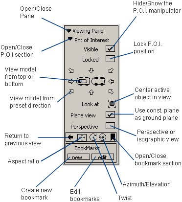

To display the View Panel
Tools
Of special interest are the following tools:
Look at
Clicking the Look at icon centers the view and zooms in on the selected objects (or all objects if nothing is picked). See also Center the view on specific objects.
Plane view
Checking Plane view lets you tumble about the currently active construction plane (that is, the construction plane is used as the ground plane).
Bookmarks
As you work on the model, you typically change the camera view back and forth between two or more areas of interest. The view panel lets you “bookmark” views of the model and return to those views by clicking the name of the bookmark.
Additionally, shading attributes (from the Diagnostic Shading panel or WindowDisplay > Hardware Shade ), and annotations (created using tools in the Paint tab) are stored in bookmarks.
When switching from one bookmark (or view) to the next, the camera is animated to take you smoothly from one view to another without getting disoriented.
The time (in seconds) taken to transition from one view to the next is controlled by the View transition time option in Preferences > General Preferences (Viewing section).
The default is 0.5 seconds. When this value is set to 0.0, the smooth animation is turned off.
See Bookmark an annotated model or more details on annotating bookmarks.
