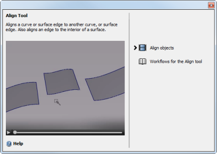

Level 2 ToolClip
Level 2 ToolClips are optional and are used when additional learning content exists. When a level 2 ToolClip exists, the More button appears in the level 1 ToolClip window.
Level 2 ToolClip with level 2 data
The following attributes define parts of a level 2 ToolClip.
  • <expanded> – Encloses all level 2 ToolClip data. If a ToolClip contains an expanded section, the More button appears in the level 1 ToolClip window.
  • <default-resource> – (Optional) Specifies that a particular video or image resource within the ToolClip's resource list can be loaded into the viewer/player when the level 2 ToolClip is opened. The <index> attribute determines which resource list item is loaded in the viewer or player. For example, set the value to 2 to display the second item in the list. By default, the <index> attribute is set to 1.
  • <resourcelist> – Specifies the list of resources to be displayed in the level 2 ToolClip window. You can include videos, images, and/or links to external resources.
  • <video> – Adds a video to the resource list. Use the <location> attribute to indicate the name of the file and the title that appears in the ToolClip window. When creating custom ToolClips, all videos must be in WebM format and located in the users.toolclips\Resources or <customdirectory>\Resources subdirectory. The video resolution should be 304 x 228 (4:3 aspect ratio).
  • <image> – Adds an image to the resource list. Use the <location> attribute to indicate the name of the file and the title that appears in the ToolClip window. When creating custom ToolClips, all images must be in JPEG or PNG format and located in the users.toolclips\Resources or <customdirectory>\Resources subdirectory. The image resolution should be 304 x 228.
  • <link> – Adds an external link to the resource list. Use the location attribute to indicate the location of the link and the title that appears in the ToolClip window. The location can be a fully qualified URL or an internal help string (as shown in the example code below).

		<expanded>
            <resourcelist>
                <video location="Align.webm">Align objects</video>
                <link location="files/Workflows_for_the_Align_tool.htm">Workflows for the Align tool</link>
            </resourcelist>
        </expanded>
