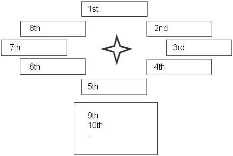

Arrange the tools and diagnostic shaders on a menu
The order of the tools and shaders on the marking menu shelf controls what position they occupy on the marking menu:
