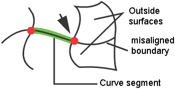

Conflicting surfaces incident at endpoint(s) There may be a conflict between the normals or curvatures of the surfaces (outside the network) which meet at this intersection.
The intersection causing the problem is indicated with an arrow. Check the alignment of the surfaces at the endpoint of the curve segment, and reshape to provide required continuity.

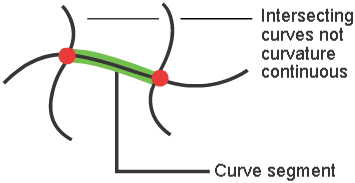

Problem curve at endpoint(s) One or both of the curves intersecting this curve segment do not have sufficient curvature quality.
The intersection causing the problem is indicated with an arrow. Use the Curve curvature measurement tool to check the curvature of the intersecting curves.

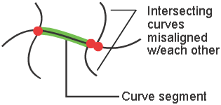

Align curves at edge end(s) The curves intersecting this curve segment are badly misaligned.
Check the alignment of both pairs of curve segments.

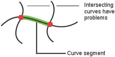

Smooth curve incident at ends One or both of the curves intersecting this curve segment have some kind of quality problem.
Turn on display of edit points and look for bunched up edit points on the intersecting curves. Use the Curve curvature measurement tool to check the curvature of the intersecting curves. Use the Smooth tool to smooth the intersecting curves.

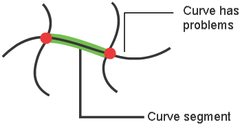

Check edge curve for problems The curves that this curve segment belongs to has some kind of quality problem.
Turn on display of edit points and look for bunched up edit points. Use the Curve curvature measurement tool to check the curve’s curvature. Use the Smooth tool to smooth the curve.

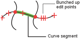

Check knot spacing on edge curve The curve that this curve segment belongs to may have “bunched up” edit points or multi-knots.
Edit or rebuild the curve to spread out the edit points.
