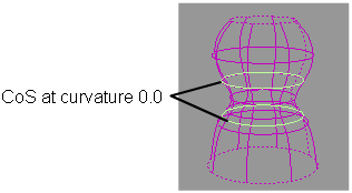

Create curves on surface from curvature data
To create curves-on-surface along lines of constant curvature:
  1. Pick the surfaces on which you want to create curves-on-surface.
  2. Choose Evaluate > Surface Evaluate > Curvature .
    The Curvature control window opens.
  3. Click the Go button.
    Curves-on-surface are created.
  4. Set the following options in the control window:
    • The Curvature Type.
    • The Curvature Value at which you want to create curves on surface. For example, enter 0 to create curves-on-surface along inflection lines.
    • Set the Subdivision option from 1 to 6. The higher the number, the more precise the result. Use low values for draft quality, use higher values for final results.
    The curves-on-surface update as the option values are modified.
    If Auto Update is off, click Update to create the curves-on-surface.
  5. Click on additional surfaces to evaluate them, or deselect active surfaces.
  6. Click the Undo All button in the control window to remove the curves-on-surface.
