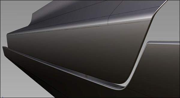

The Surfaces > Rolled Edge > Panel Gap tool is the ultimate rolled edge tool, allowing you to create the many surfaces that define a finished panel gap, including the flanges (that define the edges) , the fillets between the panel and the edges, and an optional close-out surface at the bottom of the gap.
Example of a panel gap.

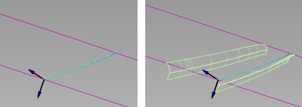

  1. Selection of one or more tangent continuous surface curves. This provides all the required input to define the gap conditions.

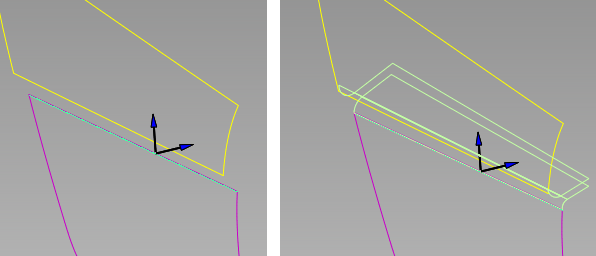

  2. Additional selection of a set of tangent continuous surfaces (shown in yellow below), that may be offset from the primary surface(s), and which are used to build the secondary fillet and flange .

  2. Pick a surface curve, or several tangent continuous surface curves (defining one side of the gap).
    The curve is highlighted in green, and the surface turns pink.

    • If you want to select adjacent surfaces from which to build the second set of fillets and flanges, click the Adjacent Surfaces button.
  4. Select a set of tangent continuous surfaces (where the secondary fillets and flanges will be located) and click the Build button.
    The surfaces turn yellow.

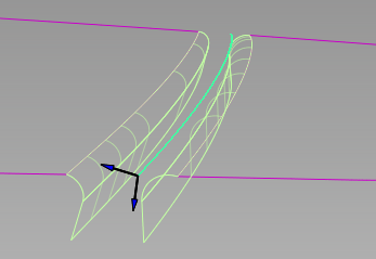

  5. Click on the blue arrows, if necessary, to change the direction of the fillets/flanges or gap, and click the Build button.
    Primary and secondary fillets and flanges are built. The panel surface is automatically trimmed to the edges of the fillets to create the gap.

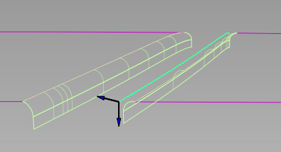

    Gap built along a curve-on-surface within a single panel surface

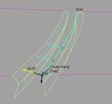

  8. To create a variable gap, turn on Variable geometry, then click on the surface curve(s) to place gap manipulators, and adjust their position and width. You can also vary the direction of the primary (draft) vector, or secondary vector along the gap. See Using the manipulators to create a variable gap for details.
