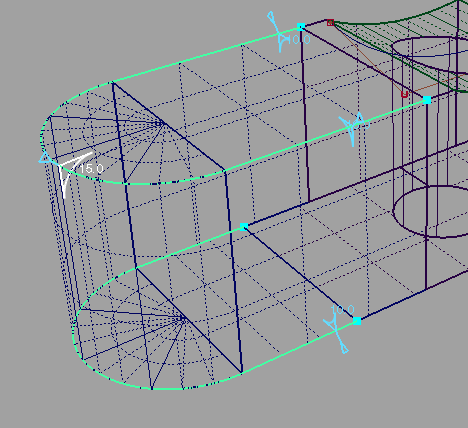

Create surfaces that round off the edges and corners between existing surfaces.
Create fillets along edges only
- Choose Surfaces > Round
- Select an edge shared by two surfaces which meet at an angle.
The common edge is highlighted in green with two blue squares indicating the end points.
A radius manipulator with a radius value appears on each edge.
- Click on the manipulator handles to move it or change the radius value (See the section Using the Radius manipulator for more information). You can also type a new radius value through the keyboard.
- Click on the edge to add extra radius manipulators at those locations and adjust the radii.
This will set the fillet radius at those points. You can specify as many radii along an edge as you want.
Note:
Hold
and click on an edge or radius to remove it.
- Repeat steps 2 to 4 for any number of shared edges on your model.
If two edges are tangent continuous, they are treated as a single edge and a single fillet is built.
- Click the Build button.
Fillet surfaces are built along each shared edge. All new surfaces are grouped under the same DAG node.
- You can still modify the radius manipulators and click Build again to rebuild the surfaces.
- If you need to select extra edges or deselect some edges at this point, click the Revert button.
The fillets are removed and surfaces are untrimmed. You can then select/deselect edges (by holding the
key) then click Build again.

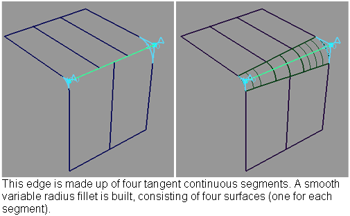

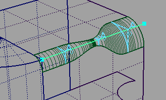

Notes on variable radius fillets

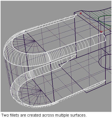

- You can add as many radius manipulators as you want to set the radius of the fillet at several point along the edge.
- Even if you do not place radius manipulators at each end of an edge, the fillet will extend from one end of the edge to the other. The fillet radius at each end of the edge will be the same as that of the outer radius manipulators.
- If two or more edges are tangent continuous, they are treated as a single edge. Creating a smooth variable radius fillet across the surfaces then requires only two radius manipulators (rather than one for each edge). However, the fillet will be made up of a separate surface for each edge.

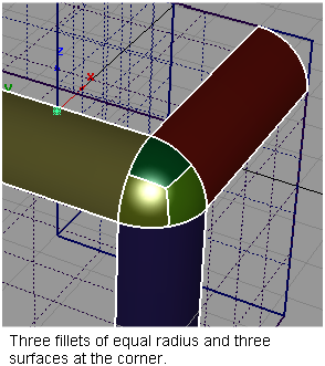

Create round corners
- Select three or four edges (each shared by two surfaces) that meet at a corner.
The shared edges are highlighted in green with blue squares indicating the end points.
A corner shape manipulator appears at the corner.
- Click on a radius manipulator handles to move it or change the radius value (See the section Using the Radius manipulator for more information). You can also type a new radius value through the keyboard.
- Click on an edge to add extra radius manipulators at those locations and adjust the radii.
Note:
Hold
- Click on the corner shape manipulator to toggle between the different corner types (see Using the Corner shape manipulator).
- Repeat steps 2 to 5 for any number of corners on your model.
If two edges touch, they will be treated as a single edge and a single fillet will be built.
Fillet surfaces are built along each shared edge, and corner surfaces are built at the corners between fillets. All new surfaces are grouped under the same DAG node.
The fillets and corner surfaces are removed, and surfaces are untrimmed. You can then select/deselect edges, then click Build again.

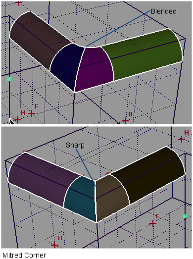

Create mitered corners

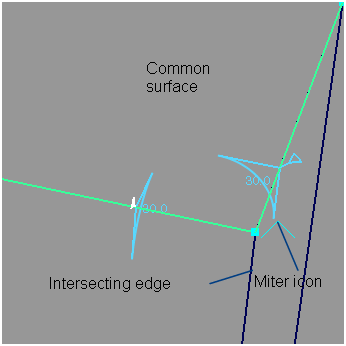

To successfully create a mitered surface, one surface is common to both edges; the other two surfaces must intersect.
- Select two edges that meet at a corner.
Radius manipulators and a corner shape manipulator appear.
- Adjust the radii on the two edges as desired.
- Click on the corner shape manipulator to toggle between Sharp and Blended corner treatment.
Four surfaces are built: two fillets and two surfaces at the corner.
Note:
If one of the two edges has a radius of 0.0, no corner surfaces are built, only a single fillet.
- If you need to select extra edges or deselect some edges, click the Revert button.

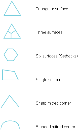

Use the Corner shape manipulator
This manipulator can have one of six possible shapes:
Clicking on it will toggle it between all the possible choices for the corner geometry. The shapes available depend on the radii of the fillets incident on the corner.
This manipulator only appears when creating corners.
For more information on the different corner types, see Options in Surfaces > Round
