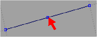

Split a keypoint curve
  1. Choose Keypoint Curve Tools > Break & Join > Break Curve at Keypoint.
  2. Click a keypoint on a keypoint curve.

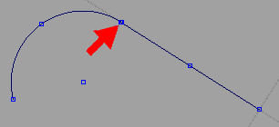

Join two keypoint curves
The two curves must overlap at their endpoint.
  1. Choose Keypoint Curve Tools > Break & Join > Join Curves.
  2. Click on the overlapping keypoint at the end of the curves.
    Note:
    You can also join regular curves by clicking on the overlapping edit points at the end of the curves.
