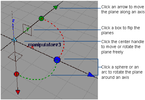

- Use the plane manipulator to set the symmetry plane:
- Click Set Plane.
How do I use the plane manipulator?
- To quickly snap the manipulator to the end of a curve, click the center move handle, then use curve snapping to snap the manipulator to the curve.
- Drag a handle to move or rotate.
- Click an arrow to change the center handle to the free move handle. Then drag the center handle to move the plane.
- Click a sphere to change the center handle to the free rotate handle. Then drag the center handle to rotate the plane.
